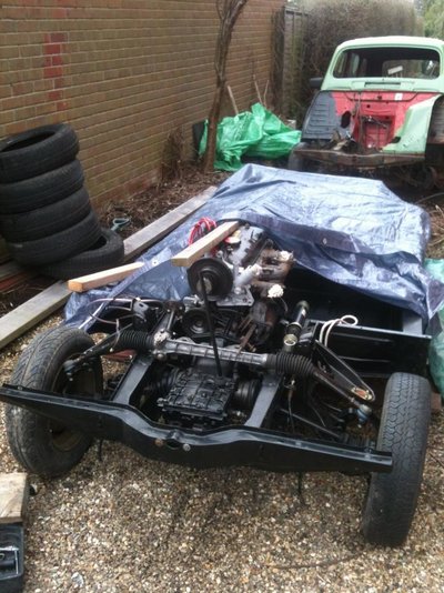

I'm pleased as punch. This weekend saw my project finally get to a meaningful stage, with the engine back in, drive shafts connected, and all fours wheels rolling!
This is by necessity a slow restoration, all work being done al-fresco. You can how far I've got with the donor body in the background.
My question today is about fuel pipe. From the tank, does this need to be steel, copper or modern rubber/plastic tube?
