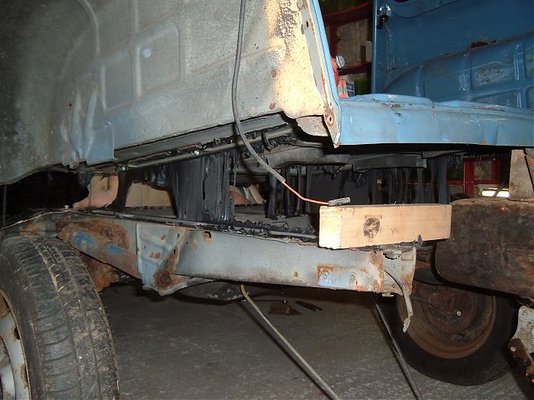

4: It's a pain to remove the body as the original sealant between body and chassis sticks very well (photo attached). I'd tend to leave the body on unless it really needs to be removed for repairs, as the sealant is good for preventing rust too.
