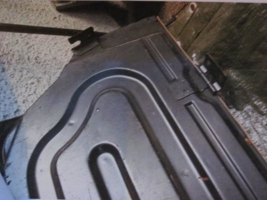

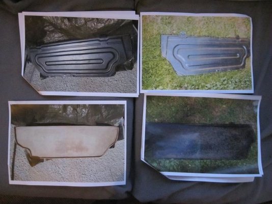

I got two local quotes here. one is covered with vinyl and onether is plain metal.
I am gonna give a shot to modify one of these.I think hinges will not fit, because they are located so far away from my vertical tubes.
What i could try is to make one additional support besides the existing ones of steel
there is also somekind of hole? in the middle towards boot lid, what is that for?

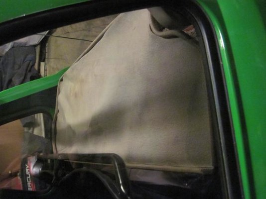

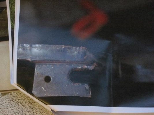

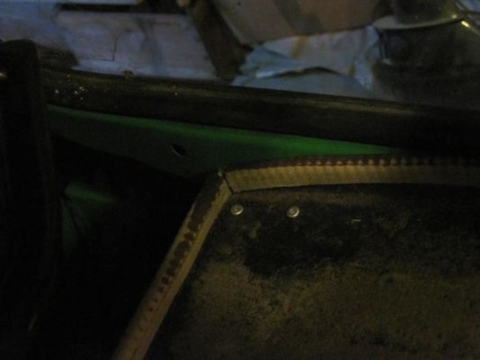

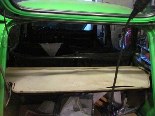

parcel shelf mod done!
now i am halfway done, fixed 2nd supports for the 2nd row of rubber rollers, i took a drawing also for others if someone going to make alike mod for their R4's
Now i have to do some polishing and painting plus get new black vinyl or alike.
I think i could use the old edge tring but only to be painted/coloured to black with some shoe/leather paint.
Some photos for the most curious of y
