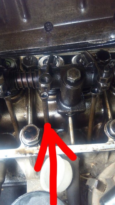

Jambo....after drive for a while. I notice a certain noise in engine..it was a big noice I decided to park my car..l open cover....it was taper valve get lost..my mechanics tell m its is in side the engine..so he give another tapet valve and fix it...but it consume fuel a lot....
I want to change and put taper valve of 850cc Renault while mine is 1100cc..The question came is it going to be the same those tapet?
Take a look to those pictures

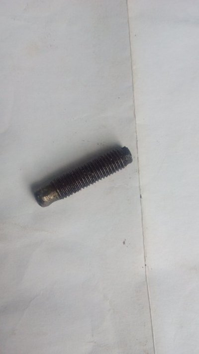

This is the tapet which l put l don't know it belong to what kind of a car....
Here there is Renault tapet valve and the one I fix....see the difference
If l use tapet valve of Renault 850cc engine is it going to fit in my 1100cc engine? I will appreciate your help
Hello Ndelilio, the part you are looking for is the adjustment stud. It has a ball shape at the bottom to fit into the cup of the pushrod.
Are you sure that it is still not in the top somewhere, because there is no way for it to fall through into the bottom of the engine.
After you screw it into the rocker arm, it is also supposed to have a locking nut at the top to keep it tight and in place.
I'm pretty sure that the studs are the same in both engines, 850 and 1100.
In your photo the studs on the left and right are also not fitted into the push rod cups. Did you loosen them as well? When you find a replacement, make sure that you adjust the valve clearance on the other side of the rocker arm with a feeler gauge. Very important otherwise you will break something.

I would suggest that the 850cc one would be a worthwhile substitute if you have it already. I would only use this as a TEMPORARY SOLUTION at this stage.

I'm quite sure that the missing adjustment stud must be somewhere on top of the cilinder head.
Maybe in one of the corners. On the outer edges. There is no space big enough for it to end up in the sump underneath the engine.
Take a good look again.
An adjustment stud from a 845 will do fine if you can find one. Or I'll be happy to send you one from a 1100.
