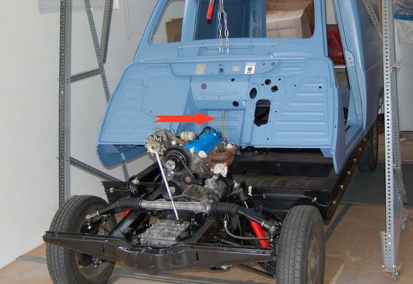

Alewis is right, it's right in the middle behind the engine.
I attached a photo of the drain and the attached tube.

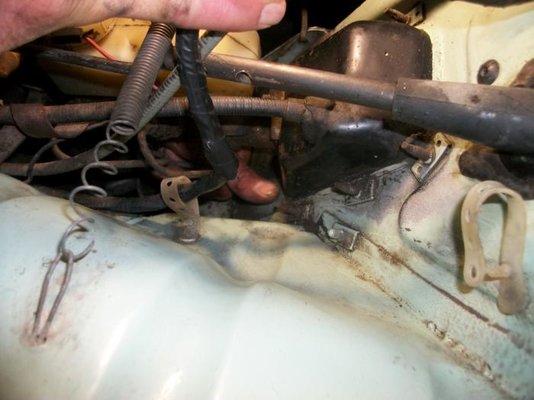

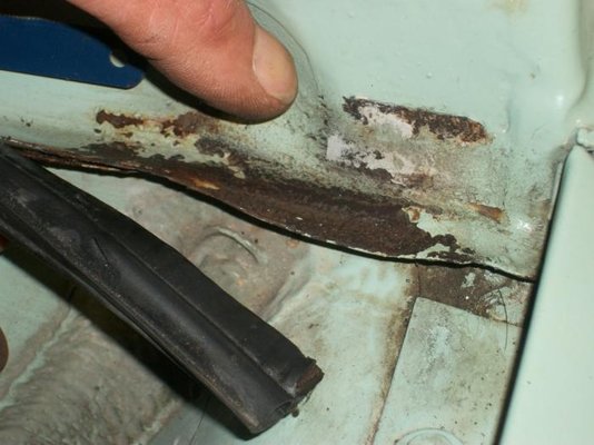

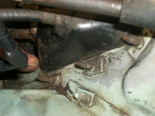

I did however look at the end of the channel below the windscreen. As you can see from the photos below, the rubber trim on the channel ended a bit short. When I pulled it off I found that the channel lip was flattened out thus letting water run down the corner of the bulkhead and the side.
At a certain point it left the corner and seeped into an opening between the bulkhead and the locating bracket (where the shaft from the brake pedal comes through to the master cylinder)
From there it dripped down behind the floor mat and puddled underneath causing untold damage.
I have now bent the channel wall upwards and extended the rubber trim so that the water flows out the end hole and down into the wheel chamber. Too little too late!
