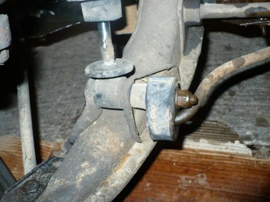

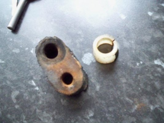

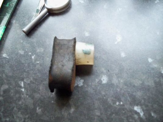

I discovered that my 1984 R4 GTL anti roll bar bushes are split however, I have never come across this type before with a cone shaped bush where the anti roll bar joins the front shocker.
The measurements of the cylinderical bush is 22mm long, inner measurements are 18mm at one end and 20mm approx at the other end.
Can anyone enlighten me on this type of bush and where to buy them or similar replacements.

Are they necesary?
What is their purpose?
MIne are also broken but are cilindrical shape.
I am planing to go tu turner and make them out of some kind hard plastic.
I have feeleing that yours got wasted from use

I must say that one i have removed from car is exactly the same to the one on link that i have give but in addition there is white plastic ring over metal sleeve.
New one that i have bought does not have plastic ring, and sleeve is not bigger in outer diameter
the plastic part is no longer available (7705002001) from Renault, looks like it give a bit of extra protection from any lateral forces on the anti roll bar bush. best advice is to get some made up in ali from someone who has a lathe- easy enough using those measurements.

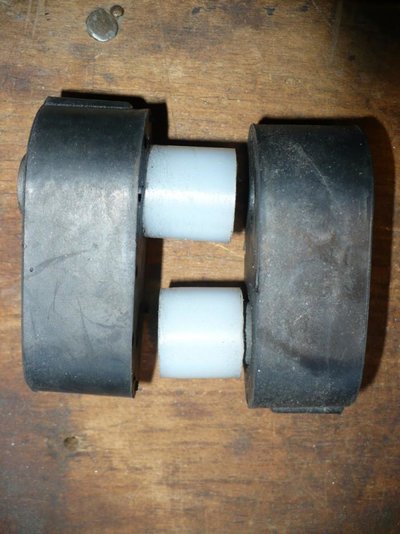

Here are fresh made two rings.
Material that i have used is PA6
All has been done at local lathe guy.
Luckily he is doing everything for fishing boats (trawler and purse seine fishing boats) so he had material in his workshop. This material fisherman are using for rollers that guides nets when they pull nets from sea.
Cut out and pressed on metal tube for some 15min.
He did not wanted to tell me price for job, but have left him something for drink.
Usual "price" in small towns across Croatia for small services like this one.
Plus i know guy quite well. He is making shafts for vessels according to mine calculations and drawings!
They look great petak, that material is very durable, (hard wearing), so it should last a long time. I've replaced my anti-roll bar with a stiffer one from a R5 Turbo (16mm dia), and noticed one of the these spacers was split, so it looks like I'm going to have to do the same.:cool:
