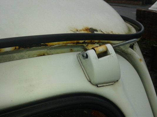

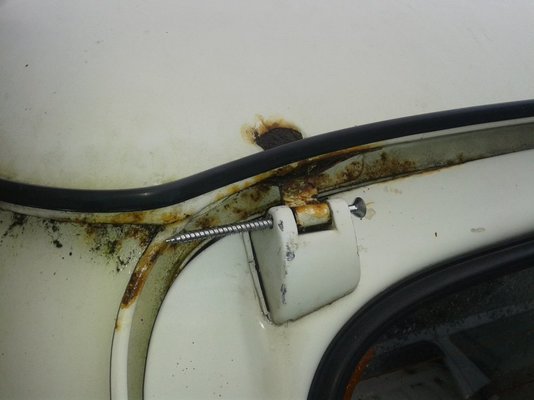

Eoynteenie Planning an Advent4 Messages 565 Location South Coast Nov 26, 2014 #1 Ok, Savanna's tailgate is hanging off because someone removed the pinions and replaced them with very long wood screws. Due to this, one side has dropped down and now starting to rust. 20141126_104004.jpg 85.6 KB · Views: 2 20141126_104009.jpg 82.1 KB · Views: 2
C christoph Enthusiast Messages 49 Nov 28, 2014 #3 You will need to use roll pins to attach hinges after any repairs as used on door hinges
