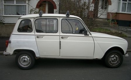

The front wheels on my R4 look different from the rear ones, its a later one so front discs and rear drums. Are all the wheels interchangeable, or are the front ones specific to discs and the rears to drums?
See the pic.

The rear ones are more normal all round on a GTL. Not sure what the front ones are from - possibly a Renault 5 of some sort.
hi rich
wheel on front is early 5 gtl/ts will be ok as designed for disk brakes and no problem on back either
what wont work is trying to bolt a wheel off 845 drum brake model onto disk braked car
easily identified by lack of air vent holes in rim and (usually but not always) a threaded bolt hole in centre for hub cap ,but they can be used on back safely

Those front ones were fitted to late TL cars called Savanne in France, but were originally from the 5 I think.
The late French GTL R4s called Clans had different wheels again, from the 5 GTL, I believe.
This is indeed a late (88) french TL, does that mean its a Savanne?

So the early drum wheels wont go on a later model with disc brakes, but will a later disc wheel go on an earlier drum brake model?

to answer your Q yes wheelrims with vents (or alloys) off disk braked cars are fine on drum braked cars
hope youve got correct nuts for alloys ?
the clan spoke effect (rostyle) wheels were used on Le Car mk1 5s 1984/5 as runout model before super cinque
