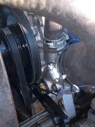

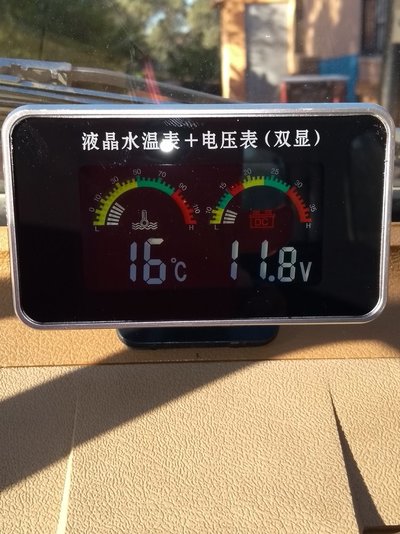

Hi . I bought an electronic gauge for 12 euros and it seems to work fine it shows coolant temperature and voltage . Screwed the sensor into the new water pump and ran the two wires to the dash board and then the other two wires connected red to a switched live at ignition and the black to earth . It really seems to work well .
I connected a bicycle pump that has a pressure gauge on it to the expansion pipe from the radiator and pumped till it read about 12 PSI and it showed where I had small water leaks from joints in pipes so they are now corrected . Then I connected the pump to the expansion pipe on the expansion tank with water in it and there it showed air escaping at about 5 PSI . All leaks cured and a new 0.7 bar pressure cap fitted and just waiting till I have time to test drive my baby .
