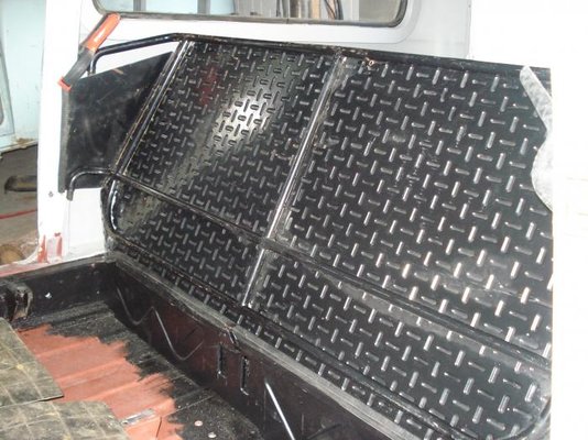

Latest eBay purchase is a back protector for an F4. You do not see them that often but they are a must-have if you carry anything heavy in an F4 - experience has taught me ! I think they were made originally for the post office vans (this one came from a ex- LaPoste van) but I am sure someone out there has a part number for it .....
Unfortunately there are no brackets ,unless anyone has them sitting unloved in a box in the garage ! However I can make something easily enough
The only problem in fitting it is that you lose access to the tool box and with a Sinpar, I will need to reposition the spare wheel - roofrack ?

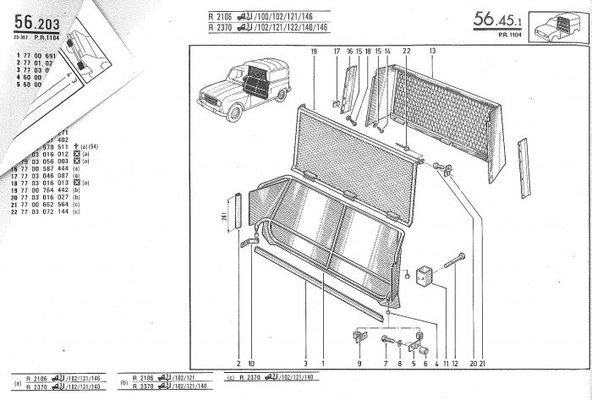

Here is the page from the PR1104 parts book...it seems that it was only fitted to French, Italian, Austrian and Swiss market Fourgonettes. The missing part number is 08 21 556 900 according to an earlier parts book.
I hope you got an idea about the missing brackets.

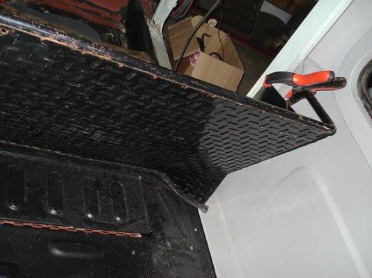

I have a complete unused divider or protector (grey primered)also have upper part included.as I have reg'd Roffen as a 2seater passenger-car (not a van) I haven't bothered fitting this
-If reg'd as a van it is required by law to have it installed at all times here in Norwayland.
-as you say it demands removing of the tool-box and makes it a hassle every time you need anything laying in the rear,so most likely I will never use it .
