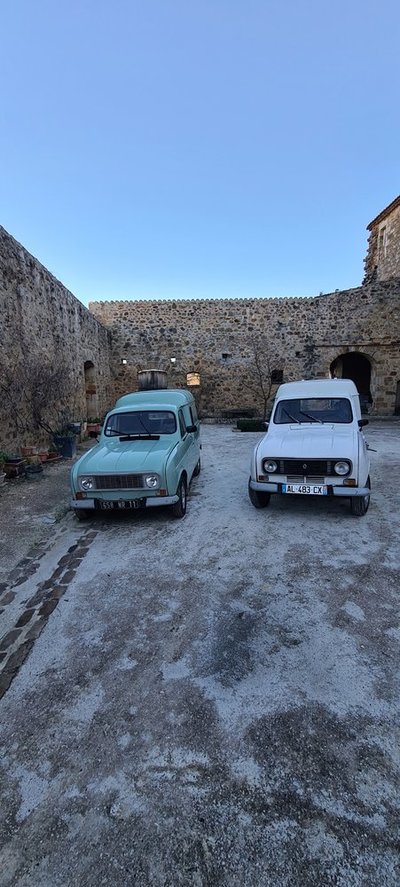

Hello i am at the montca bit baffled by my F4. Fir no apoarent reason she wont start!! I am a fairly good ,but by no means expert, (obviously!!)mechanic.
I have checked everything, condensir points plugs and of ciurse fuel arriving.
The problem is that there is no spark at the plugs!! Changed the plugs and no difference. Checked the bobin and condensor on my other 4l f6 and they work. The points are fine and set correctly.
Anyone got any ideas,as im stuck!!

Hello thanks for replying, i have tried three condensors. I am pretty sure now after tinkering for a while today, as you say its the bobin or the ignition switch. There is power to the bobin ,but if take the central wire out of the distributor cap touch itvon metal and turn the engine over there is no spark. Tomorrow if ive time ill try a different bobin.It's the blue one on the left thats being tricky

No spark at the points, no i didn't change the condensor from f4 to f6! Tomorrow ill try the f6 bobin and condensor on the f4.Good job i enjoy mechanics!! Ill get there eventually and thanks for your reply.
And i didnt change the LT wire either,.Good thinking!!
