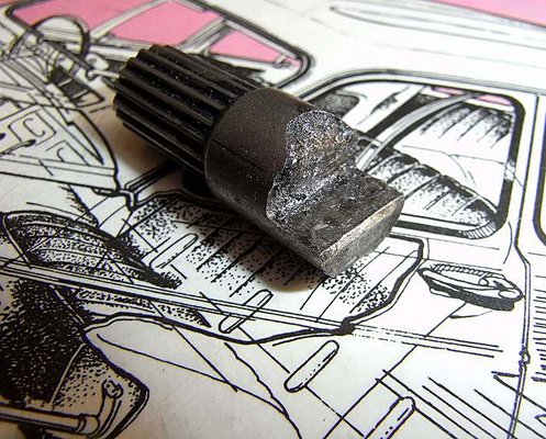

At first glance it's a very very tatty car but underneath extremely solid. It was also completely free to me as the previous owner's boyfriend was about to call in the scrappie having spent some weeks failing to diagnose the following terminal failure to proceed fault.
I've had it about five years now but what with this and that have never had, until now, the time/money/inclination to give it the tlc it deserves.Bearing in mind it's never broken down in five years of low mileage use I'm about to put some time in on the car, starting with these drat ball joint covers.
