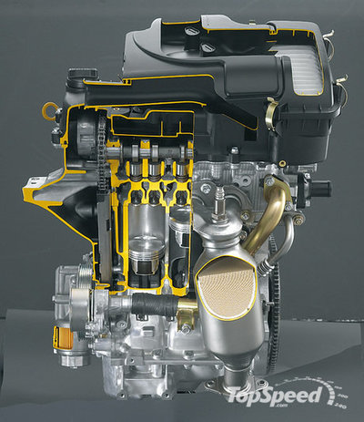

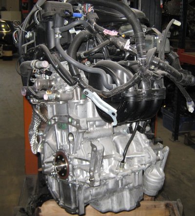

I would like to fit the most efficient small engine available at reasonable cost. To my mind his would be the 68 bhp 1.0l 3 cylinder petrol engine as fitted to the C1, Aygo, 107 range.
It would be small enough to squeeze in, nice and revvy and not too much power.
Also, it would probably be in good nick as it would be modern and there are plenty to choose from.
Any engine can be squeezed into any car, however this would not destroy the R4 character. Brakes and chassis would not be over powered and there would be a weight reduction.
Also the smaller size would help make fitting it a bit easier.
Also it would be smooth, not too noisy and give good MPG (50mpg+?). They can be bought for less than £200.
However, they have all the ancillaries bolted onto the wrong end. The water pump could be replaced by an electric item, the alternator is another matter. I have not measured the block but there is a chance the ancillaries might squeeze in against the bulkhead.
I might give it a go.
