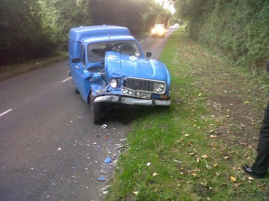

Regrettably i find myself in insurance claim land. Any thoughts? Is it worth trying to keep the poor little creature?

In my mind the key question is 'is the shell or the chassis bent from the impact?'. I suspect that the insurance assessor will write it off as cat C or D. If it is either of these catagories then it can be returned to the road with some admin. It depends on - if the chassis or body is bent, can it be repaired or will it need to be replaced? If replacement is the only option, do you want to commit yourself to the cost and grief of doing it? If it can be repaired do you equally want the cost and grief of doing it?
Unless you can source all the damaged parts and do the repair work yourself I doubt it will be cost effective to repair it (let alone replace either the shell or chassis), so it comes down to how much sentimental capital you have invested in it, and is that enough to go through the process of putting it right even though it might cost you more financially in the long run?

I suspect chassis trouble, but was awaiting the release of the new ones in the near future (though it was pretty solid, nearly knoked the back wheel off a BMW mini as the main impact was right on the chassis member at the front). The shell seems to be ok from the wings back.
Massive sentimental value and little or no bodyshop skill makes the decision really hard. I'm thinking mainly though that if I can buy it back at scrap value at least I'd have the opportunity to one day use the dash to convert ta french one.

I think you can get the front chassis members off der Franzose or possibly Melun Retro Passion. The way the bottom corner of the bonnet has been lifted up suggests front chassis member will be bent beyond repair. However, if you have a garage/space, the first step is dismantling the wreck. Then you can easily assess what requires to be done.
I have a bodywork repair manual that gives you all the information for the repair and the relevant diagonal measurements that you need, free to borrow for as long as you need it. Suspension parts should be available, given the R4's just put on this site a few weeks ago. If not I am sure someone in France will pick you one up. I am due to driving through in February and March next year, and intend to pick some bits up in passing. New after market wings and bonnet available off the shelf. As your windscreen is intact, I am sure only the front end needs working on.
It just take a little time, but not that difficult. Important to bolt everything together with some simple jig if one has to weld a new chassis member in place.
Looks like he damage is quite high to me. What did you hit, a van?

My guess from the look of the bumper is that the chassis is bent at the front. But the body looks OK behind the wings (unless the bottom of the screen is bent) so would drop onto another chassis no trouble. If it were me I'd try to hold on to the remains until new chassis are available. Even if they are not available a front end would sort it. Would be a shame to lose the good bits.

Malcolm, it was a bit tatty but good overall. The body (aside for a couple of holes in need of a weld) is almost unaffected from the wings back, although I also noticed from the picture it does look a bit like the bonnet's dented under the windscreen when it popped. I didn't notice this at the time. The little shelf under the steering column was pushed in and broken, but no sign of deformation in the floor and the doors. I had exactly the same thought about the new chassis' coming out next year... Even just to keep the dashboard to one day turn a left-hander right.
In your opinion would deformation to the bulkhead or below the windscreen be pretty much fatal?

WOW I have just listened to your voicemail and ten minutes later seen this. The bulkhead does look creased which is bad. The suspension looks un damaged as it sits ok but it's hard to tell if the chassis is pushed up.
