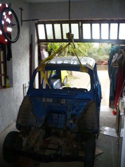

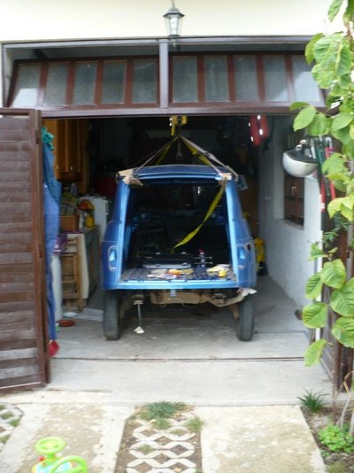

how i did it
hang car on garage ceiling hook with help of chain jack.
Raised rear wheels for about 10cm from the ground with chain jack and leave it over night.
In the morning i found chassis separated from body

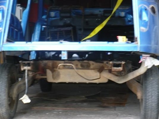

little closer picture
sorry for bad pictures but these are the best i have!
The body is held to the chassis by mastic.
The official service manual says warm it with a hairdryer to soften the mastic and the body should then lift off.
