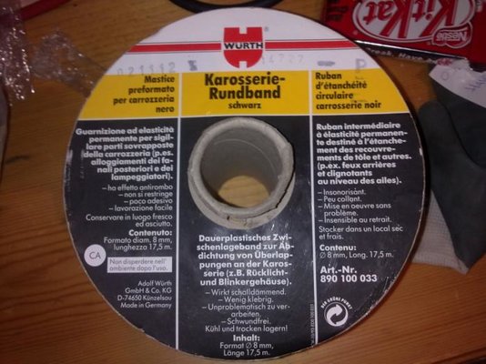

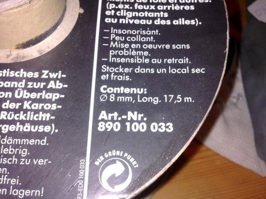

I am planing to use wuerth product.
This one!

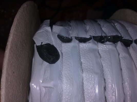

I think it is butilen rubber very similar to original one.
Does not get harden over the time
Hope that 17,5m will be enough for whole chassis
