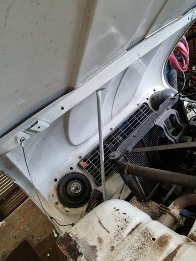

Hi all...slowly getting round to the front of the car and noticed before that my bonnet flexes a lot. Not a big issue at the moment but when you close it you have to be careful as it will land on the wing tops and once painted it's almost certainly going to cause damage. The cars had an older restoration & I think possibly a pattern/copy bonnet fitted as there's no reinforcement sections. Dave (Pascal's Pilot) all20241006_092233.jpgowed me to chop out some stru20241010_154719.jpgt sections from a scrap bonnet but I've realised there should be a complete lower 2nd skin.. any thoughts?

It looks like they fitted an earlier bonnet which would have had a 'V' shaped brace in the bottom half of the bonnet which they have cut out due to the fact that it would interfere with the front end mounted radiator on your model. The earlier model would have had a centrally mounted radiator above the steering rack which would not come into contact with the 'V' shaped brace. Once the brace is cut away, the bonnet will lose it's strength and have a wobble to it.
Indeed the bonnet is wrong as @jcarruthers2 described.

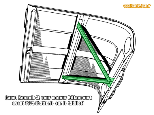

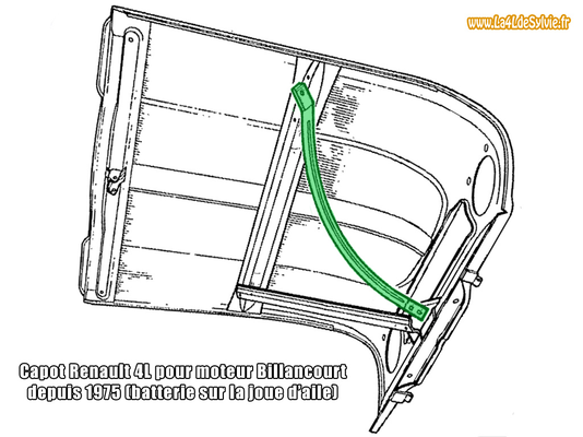

On your first picture someone fitted one of the two early bonnet models for Billancourt engine R4's, you've got a Cleon engine R4 so that someone removed a strengthening strut.
Here you see the two versions of Billancourt bonnets depending where the battery was mounted;
In green you see the strengthening struts or modificated strengthening strut.

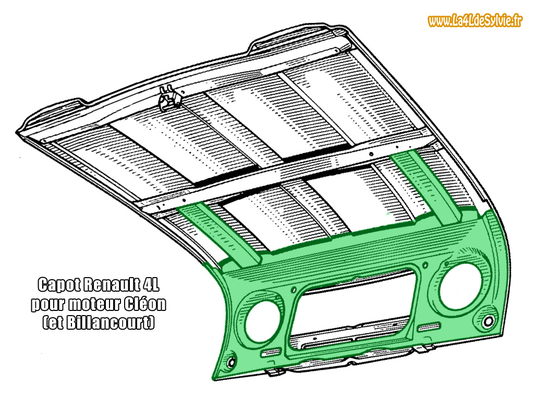

Below you see the bonnet with strengthening plates for the Cleon (and later Billancourt) engine R4 which should be mounted on your R4 as you showed on your second picture,
I think Cleon engine bonnets are still widely available, so good luck in obtaining one.

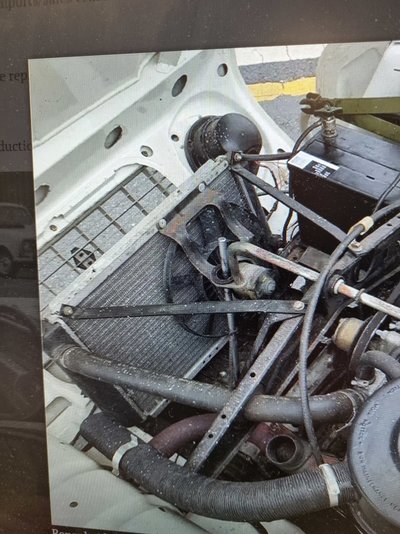

It is, possible to weld the sections that are missing in a different position to strengthen bonnet
Had to do this on friends R4 we fitted front radiator when it got converted to 5 gordini power
Will try and find pics and post later
