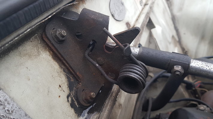

Any chance of posting a picture of the bonnet catch?
Mine doesn’t seem to be performing as it should but I don’t know what it should look like in the correct position?
Thanks Mike
I’ve tried putting the spring end back in which was easy but every time I shut /open the bonnet it comes out again?
Yours does look a little more bent over than mine…
Any other ideas??

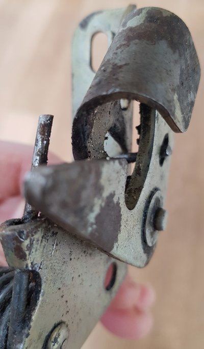

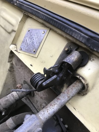

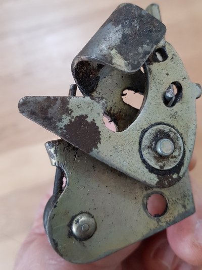

These photos might help. If you didn't feel much resistance when you replaced the spring end, the other end might be broken/not in the right place (looking at your photo again, I think that might be the case)20220305_111842.jpg20220305_111855.jpg20220305_111910.jpg:
Hi Michael
The metal tab which should hold the protruding part of the spring in place looks like it is flaring out too much which would cause the spring to jump out of place. It should have more of a hook shape to it. Compare it to Andy's bonnet catch image. You could try bending it inwards to create more of a hook to hold the spring in place. However, these springs do lose their tension and shape over time. If the spring still jumps out of place, you could drill a small hole in the bonnet catch plate near where it should hook, place the end of the spring where it should go and route a piece of metal wire through the hole and wrap it around the end of the spring and twist lock the wire to hold the end of the spring in place.
If all else fails, source a new bonnet catch.
i notice that the end of the spring is bent and is not straight as in Andys excellent photos. i think a bit of work with pliers might be needed. the other end of he spring appears to protrude enough to confirm its well located
