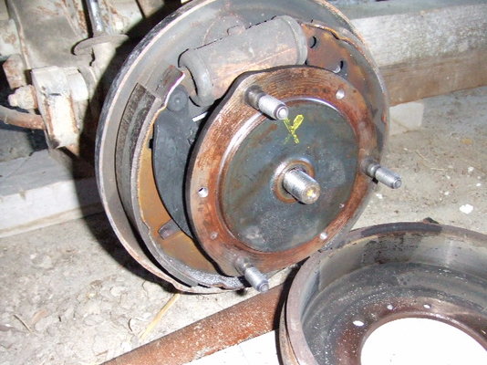

After struggling for a day, this morning I managed to borrow a drum puller from a neighbouring farmer. It came off in 2 minutes. I wish I had known before that he had one! The wheel turns very easily now that the brake shoes have been released.
I'd really like to expose the whole backplate and springs and shoes etc so I can give everything a good clean and rub on some copper grease before I replace the shoes.
Unfortunately I have no idea how to remove the hub so would welcome any advice.

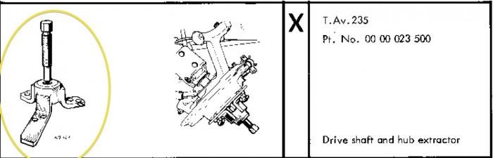

Not an easy task. The hub is press fitted onto two large bearings and you have to pull them out. You need a tool like the one in the attached picture. It bolts onto the wheel studs and the screw in the middle pushes down on the drive shaft. You can see by the thickness of the legs that it's designed for a large amount of force!

Thanks for the detailed instructions Geoff, that's a little beyond my capabilities at the moment. If I ever got it off I'd never get it back on again. I actually started off with a drum puller but when it started pushing in that centre bolt which I presume is the end of the driveshaft, I stopped immediately.
When I took the drum off I left the nut on that bolt so it didn't move
I'll just clean as best I can with a little wire brush and some cleaner.

You don't have to remove the hub to remove or replace the brake shoes. It's a very fiddly job but it can be done.
If you check under TECH TIPS--BRAKES +HUBS--REAR BRAKE SHOES, first photo. I was trying to get to that stage basically to clean everything and apply copper grease and new shoes. (although I'm busy with the front brake)
After reading the replies on your site I've decided that the hub will have to stay on while I change the pads and clean up.
