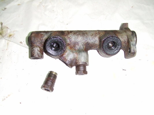

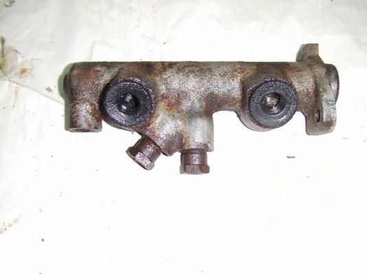

The number is 491. I took a photo of it as well.
@Malcolm The unions are still on the brake lines, above the flare.
In the photo, you can see that they screw into those adapters which in turn, screw into the master cylinder.
Thats why I'm confused with the Franzose photos . Only one of them seems to have those screw in adapters. Other than that they're identical in shape and size

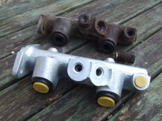

Here's a photo of my new master cylinder compared to the old one.
I'm not quite sure if the old one was a genuine Renault part, but you can see that the brake line unions screw into the adapters, one of which I've removed for the photo.
The new part has smaller openings, so the unions can be screwed directly into them.
I've been wracking my brain to find a reason for the adapters and the only answer I can come up with is that some brake lines might be a different diameter, each fitted with it's own adapter. In other words, the same master cylinder could fit a variety of hose diameters.
