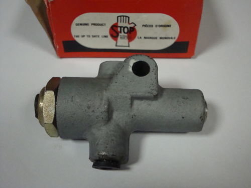

I bought this one on ebay:
Is the same shape of mine, and even if it says it was for a furgonette I hope it will work... 42 euros are a good investment.
