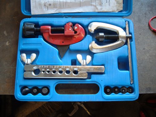

I bought my own brake flaring kit for £15 (cheap one from the motor factors). It's so handy not to have to order brake pipes individually and then have to go back because they are too long/short or have the wrong fitting.

A flaring tool and pipe bending pliers are at the top of my shopping list.Theres a great company called "Vehicle Wiring Products"that does lots of different goodies(I've got there catalogue in front of me now).
The flaring tool looks expensive. Might be worth a search around for a Sealey Model AK506 - only £15 including a pipe cutter (essential).

I bought a Sealy one years ago and didn't get on with it as the flares produced were not up to an acceptable standard (for me, anyway!). I went out and bought a Sykes Pickavant one that produces excellent flares.

I ordered the one out of the catalogue today I'll let you know how it performs once I get round to using it.I've got alot of welding to do first

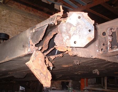

But your suspension mounting looks wrong - it should look like this: :D

Thats what it looked like before it came away in my hand.I'll keep you posted with the progress.
I started the welding earlier today,first time I've touch a mig set in 15 years(triumph vitesse,citroen dyane) guess I'm a sucker for punisment
