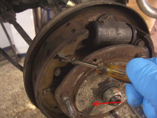

For many years I use a slim screwdriver. If you hook the brake spring over it, and insert its tip in the brake shoe hole, then push the screwdriver in the direction of the arrow, you will see the end of the spring slide over the screwdriver and neatly dropping in the hole.

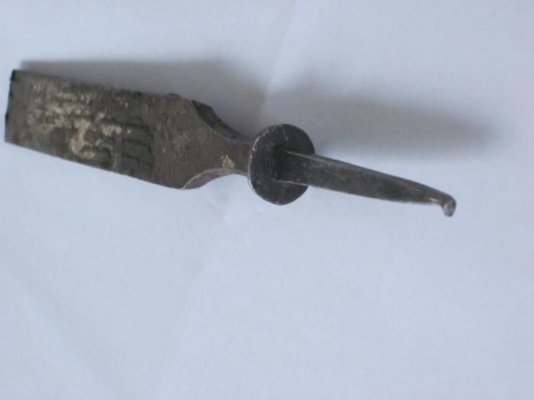

** i did use one old chisel, i mean the end that goes inside wooden handle, i bended the end so that there is 1...2mm hook (can be made with hammer on csrew jaws)
I used the screwdriver method on my daughter's R12 today. Works a treat - easiest fitting of the spring I've ever done.
