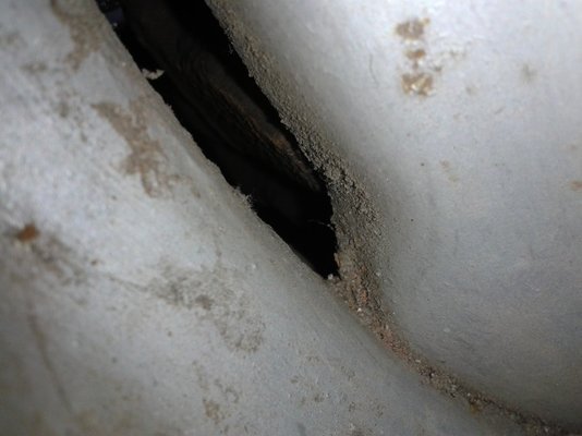

20140626_205245.jpg 20140626_205245.jpg Hi Malcolm, Angel & Petak
Just had the opportunity to explore the hub and clearances properly. I can now see clearly the problem with the 6 bolts and their interference with the wheel. Obviously the wheel needs to fit tight against the flat face of the hub.
Having examined my Calipers its clear mine are not the Bendix low profile type like Malcolm's. Its also clear there is no way without very substantial grinding could they be made to fit the higher profile Caliper. I hadn't appreciated how the bolt heads were influencing how the wheel was sitting on the hub. Flush fitting the 6 bolts actually makes the wheel interfere more with the Caliper.

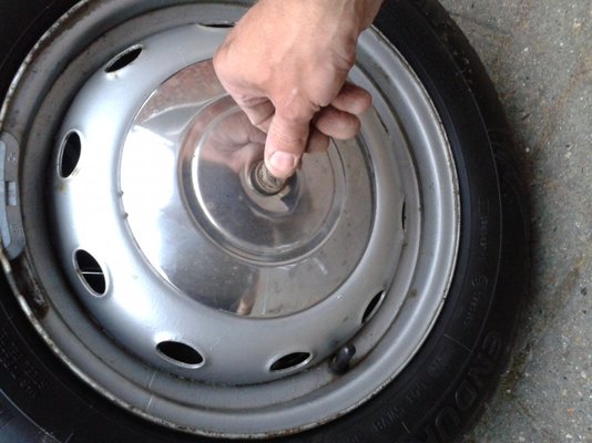

I'm going to look further into this but can see for the sake of giving way a little on my artistic front I could use the existing wheels. By making a steel 'plug' with a threaded centre I could then mount the chrome hub caps. Ok there will be holes round the edges of the wheel so I'm thinking if I can live with that. The Plug would knock out when required.
I also then have the ease of getting the wheels balanced by the local tyre company as they need a hole in the centre of the wheel to put it on their wheel balancing machine.
Not to mention cost.
Your thoughts?

I've had a look on Google Images and can see R6 wheels. They too seem to have holes round the edges (spoke like) and I can see the centre pressing is a different shape to accomodate what's behind.
Thanks for the suggestion I think I will stay with my existing wheels for now
