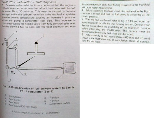

Reading Haynes manual, I found this interesting note. It is referred to a 28if carburetor, but it could be applied to a 32if as well, couldn't it? (sorry for pic quality).

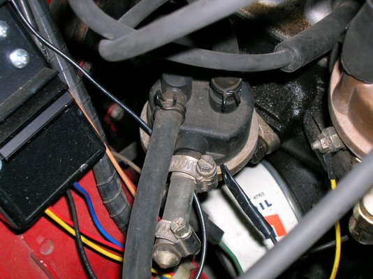

If making a fuel return line can resolve the fault, I wonder if the plugged pipe on my fuel pump is for a return line, so that I could use that to make the new line.
What do you think about it?
