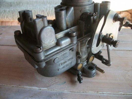

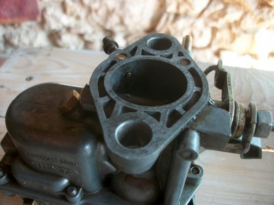

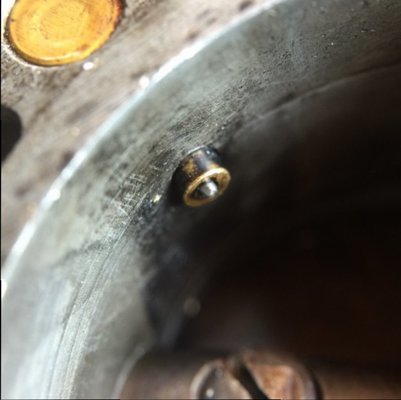

I came home, removed the carb and cleaned it thoroughly and also checked the mixture screw. I found that there was damage to the tip. I don't even think that the needle was entering the small hole in the carburetor wall, so that's why it made no difference whether I screwed the screw inwards or outwards.
I cleaned up the tip of the screw with 1500 sandpaper and now if I look to the interior of the carb I can see the pin protruding through the little hole.
my wife took the macro shot (3rd photo) with her Iphone 6

At least now that I have the tip of the mixture screw going through the little hole, if I screw it either in or out, there is a change in engine tone.
