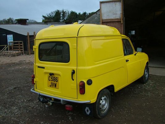

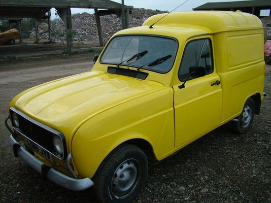

Here we have the F4 back from her MOT test. Sadly she's still in the workshop, but hopefully not for long.

Glad you like it. An awful lot of effort mainly by a friend. The van body had been sorely beaten up, and as a result has quite a lot of filler in it, so it is not perfect. Tried to find an air leak today, but couldn't. Friend who has helped me do this up suspects main jet has the broken tip of the adjusting needle left in it. He says he's seen it before with cars and bykes. Someone screws it in tightly, and then it breaks off inside the jet, so I'm on the look out for another carb.

I can't help you with technical stuff, but I have to tell you: it's beautiful!
You did a great job on that piece of metal...
You've done a great job, and I love that colour, but then I am bias, it looks like Tournesol to me, same colour as our 4. Can you not strip the carb and remove the offending needle point and then replace the needle? Our car was running very weak at one time and I simply drilled out the main-jet to 1mm from .9mm, so this might help of you have a worn carb. Emissions are now spot on, and it still does 40mpg or thereabouts. Regards Brian.
