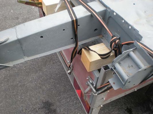

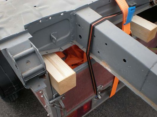

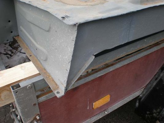

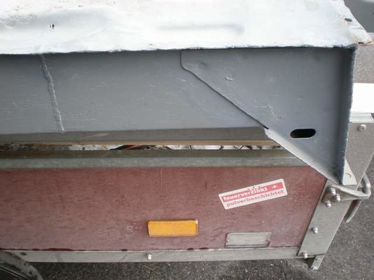

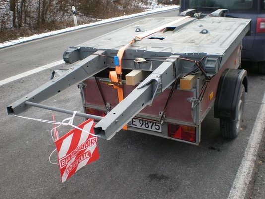

Here are some photos of the chassis taken when I picked it up last Saturday ... thankfully the snow only hit us yesterday :)
Robert

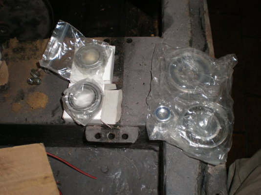

And I found two sets of wheel bearings ... the question is: Which set will fit my rear hubs on my '78 GTL?
I don't have access to the car over Christmas, but would like to have all parts ready for the transplant which is scheduled to happen after January 7th :)
Robert

Left set, it is a rear wheel one. If you measure them I can tell you for sure if it is suitable for a GTL-they have been changed three times.
Right set is a front wheel kit.
