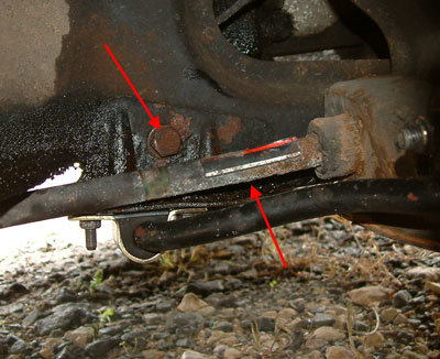

Jacked up the suspension - clunk again - lowered it - jacked it up again and watched carefully to see what moved. The RH mounting bracket for the anti-roll bar shifted slightly with a clunk - both bolts were slightly loose - now tightened and after a short test run seems OK, a test run round some of the hairpin bends round here should really test it out.

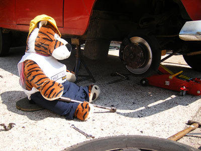

Photos show able assistant and the loose bolts (one behind the torsion bar)
