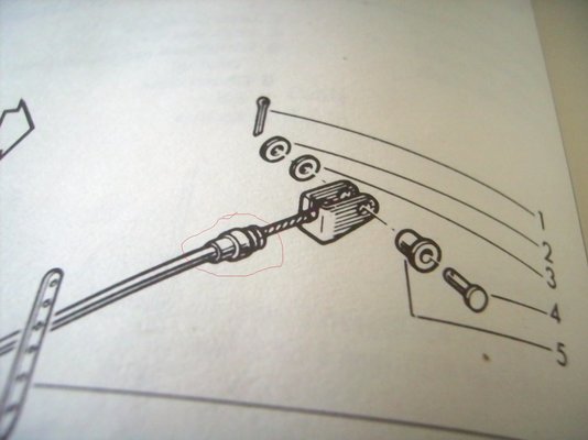

In terms of adjustment, there should be between 3-4mm play at the gearbox end. Check to see if your adjustment is correct first. With regards to the cable slipping off at the pedal end, has something popped out of place, split pin, clevis pin etc? Is the plastic end piece of the cable outer which sits in the pedal housing chewed up and does not sit flush in the pedal housing? Please see image attached of the plastic end piece which is circled in red.

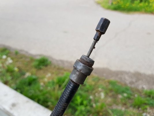

I just checked the cable, the inner part is 670 mm and the outer is 520 mm as it should be. The cable looks OK on both ends. Two years ago I've changed the cable myself and it worked just fine. I was wrong about that. After the mechanic changed the starter motor and obviously fiddled with the cable something happened, there was a wire to hold the cable in the clevis (originally there is no wire) which I threw away and now I can't get it to work.

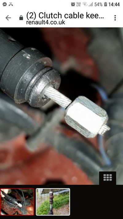

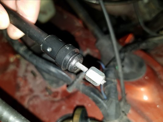

I've put it in place few moments ago and after I press the pedal few time it slipped of. I can't figure out this one. It seems that sometimes the cable is not pulled back when the pedal is released. I have to get the car to MOT tomorrow so this will be fun :D20200501_121138 (Medium).jpg20200501_152107 (Medium).jpg

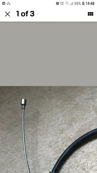

the problem is that cable has no shoulder on the nipple which locates it in place
compare these pics of genuine part to yours

Ah, just as I suggested, there's the problem. I had a RHD cable made up a few years ago by a well known cable supplier, and I had the same thing happen. I sent it back and they fitted the correct nipple.

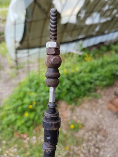

I lost my mind over this and ultimately turned the clevis the other way around. Temporary fix, not something I do. The best part is that I have an old used cable which I used to compare with this one. I didn't notice the difference.
Thank you guys, you helped a lot. I will find another cable or make a shoulder on this one :)

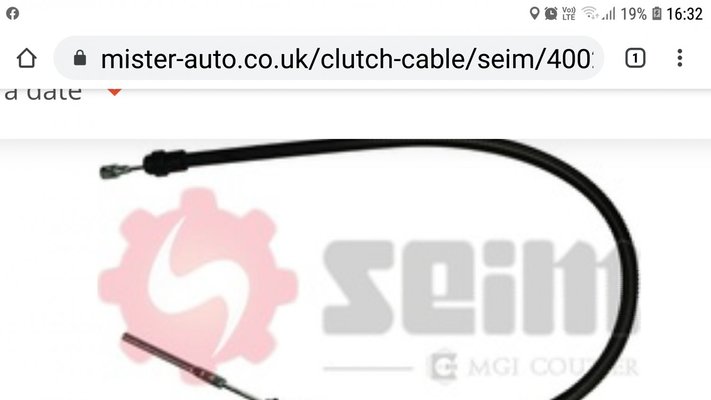

not much escapes me Brian I've just ordered a lhd cable for my rodeo
but not unpacked to check it
now found pic from Mister auto website
