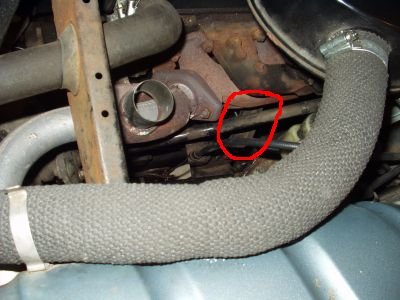

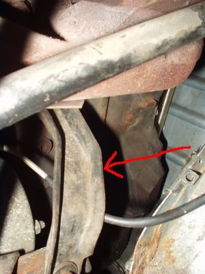

Well, the good news is, it wasn't the clutch after all!
We took the car down to Renospeed in London thinking that an entire new clutch would be needed.
Derek found that a bracket fixing the engine (and/or starter) had been removed, causing excess movement. He put in a new bracket and Richie drives beautifully now.
I can thoroughly recommend Renospeed :)
I'm surprised you were able to drive it all!! When that brackets missing the poor things are virtually undriveable.
