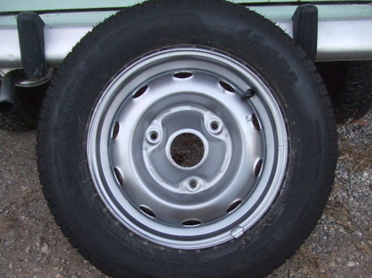

I went to a scrapyard and found a rim for 10Euros. I had them take the tyre off before I bought it and once again there was an inner tube fitted. There was quite a bit of rust once again but its fixable and far better than my one.
I think when an inner tube is fitted, water gets in the hole in the rim where the valve sticks out and causes the rust. Will definitely fit a tubeless tyre to prevent this happening again.
So here's is the second hand rim, with the rust removed, sprayed with a primer and top coat and fitted with a new tubeless Kleber 145/80 tyre.
