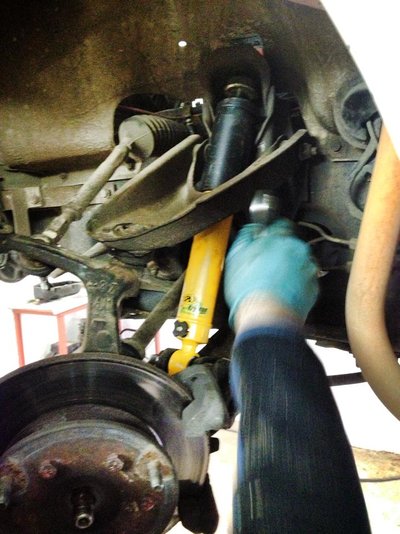

I ordered through DCPerformance, also in the UK, and as they are one of SPAX busiest distributors they were able to get them produced and shipped within a few days!
The SPAX part numbers, for a 4L - G406 and G614.

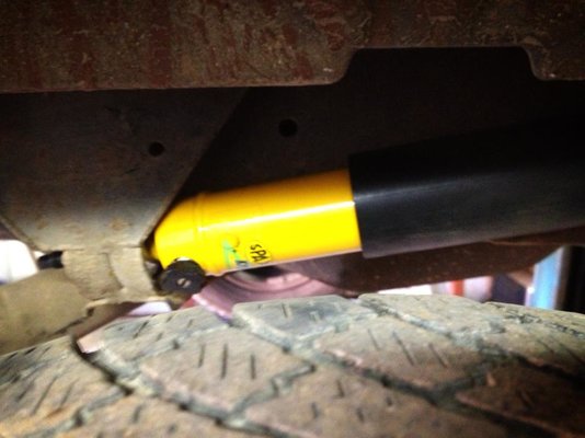

Angel, they are listed in the catalogue as made specifically for our 4Ls or vans, and installation was quick and with no issues whatsoever.
My first assessement is a bombshell, at least in my mind, in that the car is both much more comfortable as well as stable! I thought I would be trading some comfort for stiffness, but instead both are improving with each turn of the adjustment knobs...thus far.
I'll go up another 4 clicks today - still trying to find out at which setting it gets too stiff.
I've driven it for 2 days at the 10 position on all four; with a roof rack and tandem bike, and without, This morning I'll try the 14 position. Spax have a reputation for being on the stiff side [according to various forums], but I'm not getting the same impression.
