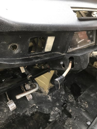

Can anyone help as I’m trying to get the dashboard out of my F6 but can’t get it past the lights & indicator stalks?
Do they unscrew??
Cheers Mike.
