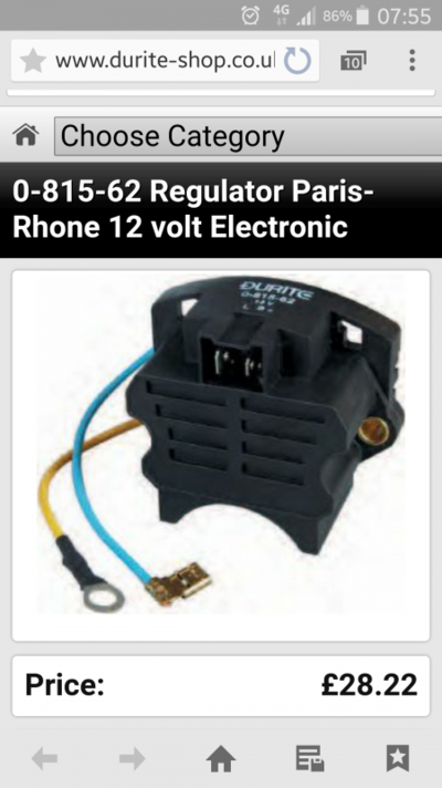

The early cars fitted with alternators 76 to 1980 did have separate regulator box not sure that they had a warning lamp just voltmeter on dash ?
Later cars had more conventional type with the voltage control built in I suspect alternator faulty but it is possible to remove brushes on some makes of alternator easily
Valeo/Paris rhone are available as an assembly with voltage regulator built in
However it may be simpler to replace alternator
Found this as an example
