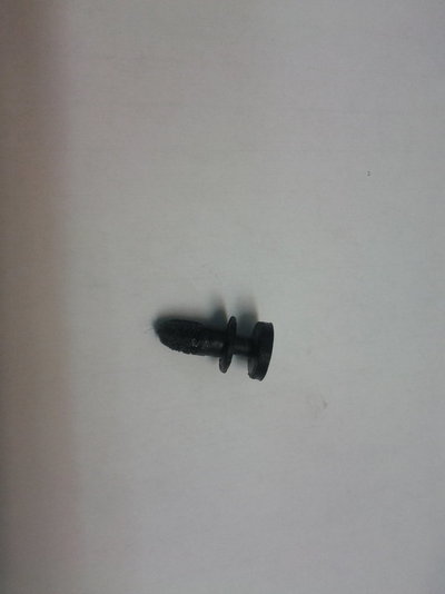

I have 3D-printed a set and need to test them for fit and eventual corrections. I'll let you know as soon as they are ready.
You are an angel. If you can change plastic colours one set black and another mid chestnut brown.
3Dprinters are amazing . Great idea.
I have just realised that the colour will not matter because the clips are covered by the door pocket . Obvious really.

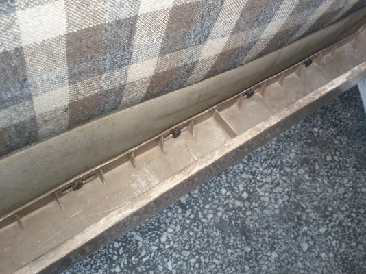

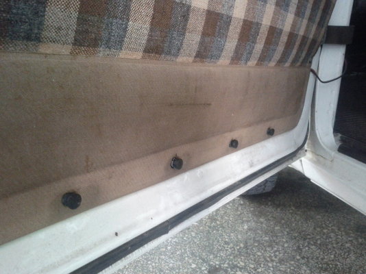

Tested a set on my GTL, they fit nicely and snugly on the door. Don't know how many removals/refittings of the door card will they stand, though.
10 euros for a set of four (one door), plus 6€ postage (independent of quantity of clips).
