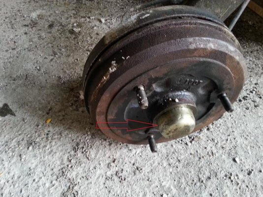

i have problem with "pintle " or "plug" i dont kown how to translate this...
i have take this off ?
its thread there ?

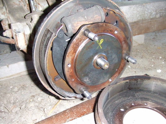

If you look at my photo, the drum is on the floor. I took it off with a drum puller.
The part with the 3 bolts is the hub. It is not necessary to remove it, if you only want to change the brake shoes or brake cylinder.
You can not take out the big bolt in the middle because it is your drive shaft.

yes. this will reveal the hub nut secured by a castellated washer and a split pin, remove these and the brake drum will fall off !
but how ? :(
what i have to use to take this off...
i spend 2 hours thinking and trying
how did you do this ?
I just did the same thing. In the end I levered it out with a small screwdriver
I could see someone else had used a big pair of pliers.
If there is a cunning knack to taking these off I would also appreciate the procedure/tool etc.
cheers
Ian

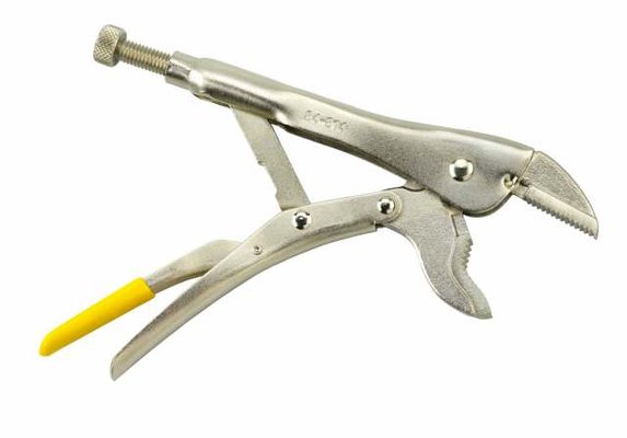

There is a special tool but it's not necessary. Big multigrip pliers, a peace of leather and a little sense will do.

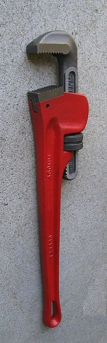

no easy way that I know of. I used these but not to tight otherwise it will get damaged

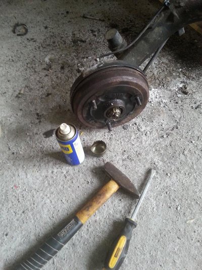

It can be removed very easily if you hit it very gently and carefully as shown on the picture, using a medium shaped flat bladed screwdriver and hammer. Alternate tapping points by half a turn, and you will have it in your hands quickly. It's not that tight.
Don't worry if you dent the cap a little, try however to "key" the screwdriver in existing dents, it will make the process easier.
