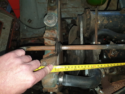

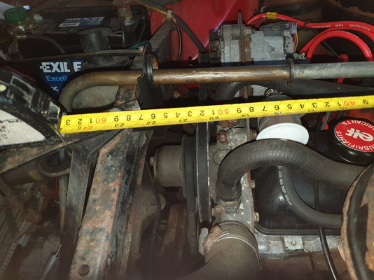

Thank you, I wondered if it is possible to retain the radiator in its original position and just add a 'push' electric fan? I really want to try and retain the original look with the larger engine.The Cleon engine with the right gearbox and bellhouse is most important.

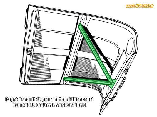

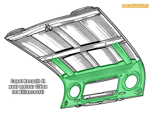

This site can give you info https://www.la4ldesylvie.fr/tutoriels-de-mecanique-et-bricolage-sur-les-renault-4
