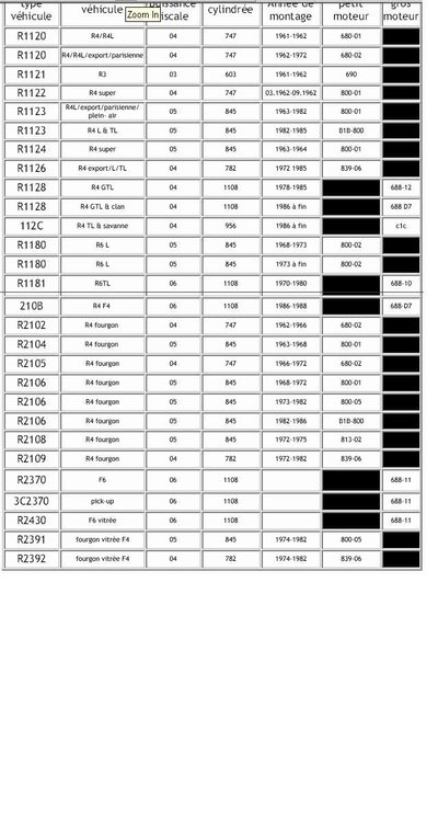

all you oh so knowledgables..my la poste van is 210B02 I understand from angel it has the spanish engine but what is 02? it is a June 1986model.
the rest of the plate is 00661372 thank you
