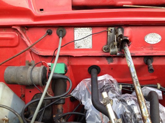

This is probably off at a tangent but I fitted an electronic ignition . It made a really significant improvement to all the range with really perky pick up on throttle. I'd thoroughly recommend it it's the little green box on top of the coil on the left.
No tangents are too far off :) What brand is your green box? I havent seen any that seems to be fit the 845, but maybe that doesnt matter?
I'll find out for you. Cost £40 which seems a lot for something the size of a matchbox! I had it picking up the pulse from the existing contact breaker. They no longer spark and it works great. But when Womble is back together I'll be using the little hall sensor which is contact less but will require a Little mod to the dizzy to fit
