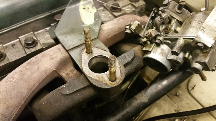

20150619_142905.jpg 20150619_142845.jpg Maybe a thought if you are experiencing flooding when hot
I have been struggling to sort Ornella the 1965 4 as after switching engine off the carb would stink of fuel
Eventually I noticed there was no spacer between carb and manifold
Found a spare and with 2 new gaskets all is well now
