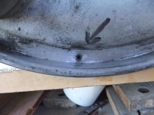

After a thorough search, I eventually found this small hole. Hopefully that's the one!!!
I did the repair with Gungum.

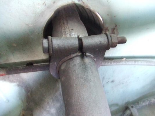

Wasn't that! still popping! But I think I've found it now.
The exhaust pipe has a join where it leaves the engine compartment and enters the wheel well. I could feel air pushing out so obviously the connection was at fault.
I pushed the pipe in deeper and tightened the clamp. Should be fine now:D
