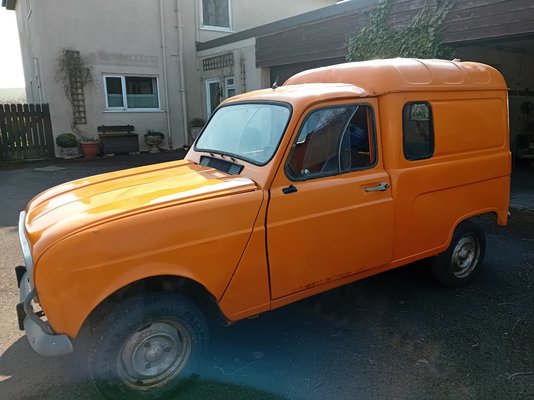

let us have a bit more info o the car please. Looks a great find.
If you are taking the tank out, there is then an opportunity to renovate it. Frost's on the internet do a two part product called POR 15 which cleans and re lines tanks , stopping them rusting inside out and also stops them being attacked by ethanol in modern petrol.
