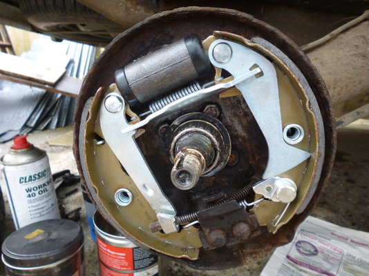

They'll probably be self-adjusting - they could be Bendix or Girling (easy to tell once the drum's off).
Here's the Bendix system:
