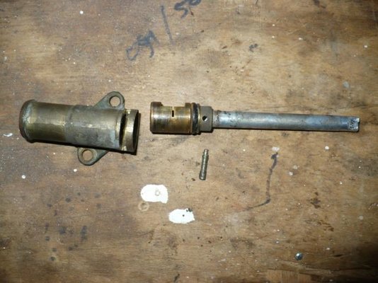

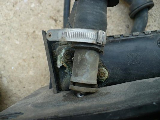

First you need to remove heater from car and take of valve removing two nuts (M6 think that they are)
This is how my once looked like

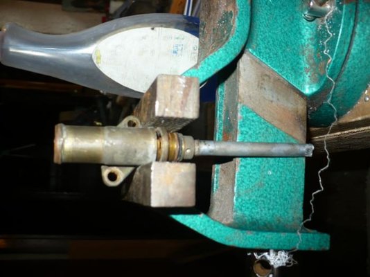

Remove small bolt that is actually limiter for rubber knob which you turn from cabin.
Not so nice picture but you will find bolt easily

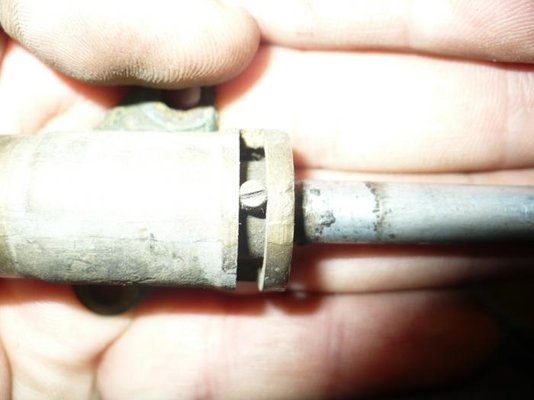

After you have unbolted that bolt just separate two sides of valve. Use some kind of clamp.
And your heater valve is opened.

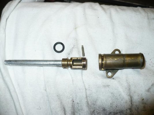

Now you must clean it with some sandpaper and change rubber sealing inside. I have found similar one in store for plumbers
Cleaned valve before reassembling
It would be smart thing to change gasket that goes between valve and matrix.
