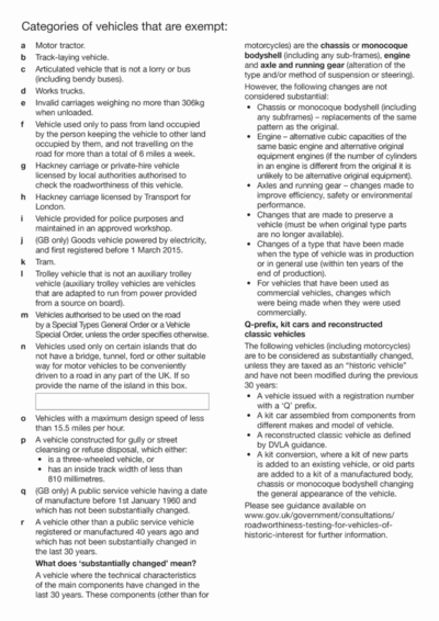

So many people on here have R4s that have had major work.
The MOT rules say that you can't get MOT exempt status if big parts have been changed in the last 30 years,
or so it seems, reading official bunf online.
Have I got this right, and if so, how do you all get MOT exempt status?
Do all the major repairs like new chassis or engine changes just go unmentioned?
My old crate (1983) is due her last MOT in March, and after that I'd like to apply for exemption....

The MOT exemption comes with tax exemption and historic vehicle status. https://www.gov.uk/historic-vehicles
The rules state that you can replace parts that wear our, you can repair, but you cant change the spec of the car. You cant put a Jag V12 in place of the 845cc engine. You couldn't put a range rover 4x4 system under a R4n body. Thats changing the vehicle's specification, which is government type approved.
