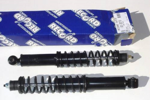

Here's a pic of the spring reinforced front shocks.
(Availlable on eBay France for 230 Euro.) :shock:
