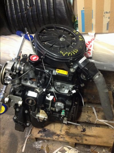

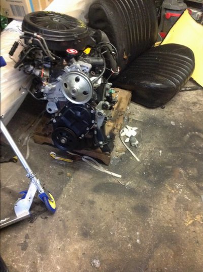

Hi it's a c3 it's got the water pump at the rear of the engine and seems to have different engine mountings,I d be grateful for any advice about how to overcome these issues ,is a Gordon's engine different? My mechanic friend has gone away to think about it ,we may just take it out and try !here s some pics. I hope

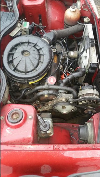

This is exactly the same engine as you have got there Brian I bought this car today as you can see the engine is designed to be mounted transversely on all the later Renault fives built from 1985 onwards
There are similarities obviously between two engines I personally wouldn't attempt it the amount of modifications needed is far greater then you are likely to be able to overcome easily20151105_141146.jpg20151105_140843.jpg

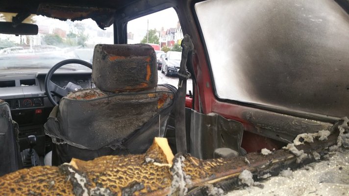

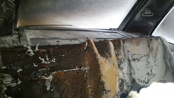

Ps the 5 I bought today is a one owner car which caught fire having welding done and will be spares only 20151105_140958.jpg20151105_141038.jpg
