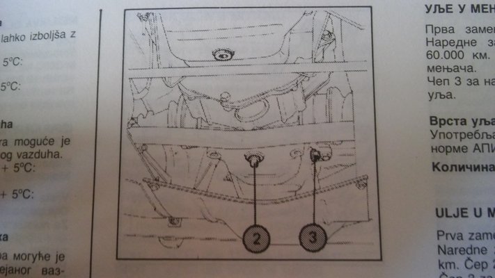

Gearbox oil
First change between 1000 and 3000 km
Additional oil change every 60000 km
Plug 2 for drainage
Plug 3 for fill up and control
Type of oil to use
Use oil quality SAE 80 W norms API GL5 or MILL 2105BorC
Oil quantity: 1,8 lit
Second picture

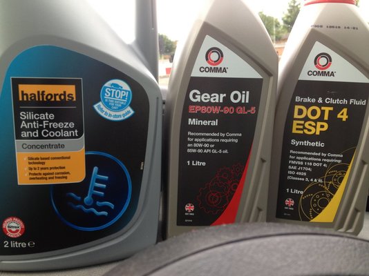

Hi guys these are the fluids I bought . The engine oil is a 'running in grade' the engine rebuilders gave me to use up to 1000miles max then I will change to modern oil spec
The gear oil is a hypoid
Have I got the right thing?
