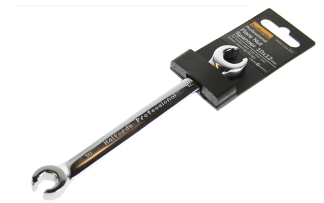

When removing the front inner wing (driver's side, RHD) you need to deal with the brake lines. What do people suggest? Mine seem a little corroded in the master cylinder but may be persuaded to come out if necessary. I'm aiming to remove the body entirely if that affects your advice. Thanks, Bob.
I'd undo them, put a bit of wd40 on to help loosen the nuts, leave for a couple of days then loosen them off, failing that I'd cut them off and replace with copper.
Be very careful when loosening the nuts if they're tight.
If you use an open ended flat spanner, they have a tendency to slip and before you know it, the nut edges will be rounded off, which makes it difficult to grip. You also can't replace the nuts because the ends of the brake lines are flared.
I bought a spanner like this, which made life a lot easier
